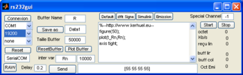

Once the .hex file is loaded into the dsPIC, you get two led blinking at 1Hz and 0.5Hz and the Explorer 16 Demo board is connected to one PC COM port.
Open the rs232gui user interface ( click twice on the block 'Interface Tx-Matlab' or type rs232gui at the matlab prompt.
Set the COM port to the one you are using (PC side) and set the baud rate to 19200 (same as dsPIC). No flow control used. Then,click on Connexion, wait 3 seconds and click on the Start button. On some PC, Matlab closed if you click on Connexion while data are being sent from the dsPIC to the PC. In that case, disconnect the dsPIC before pushing the Connexion button.
Raw and filtred data (at 1Hz and 10Hz) from the ADC 5 channel connected to the potentiometer
Moving the Potentiometer, you will obtain the following graphic with three curves : the blue curve is the raw data (unfiltred), the red curve is the data filtred at 1Hz and the green curve is the data filtered at 10Hz.
